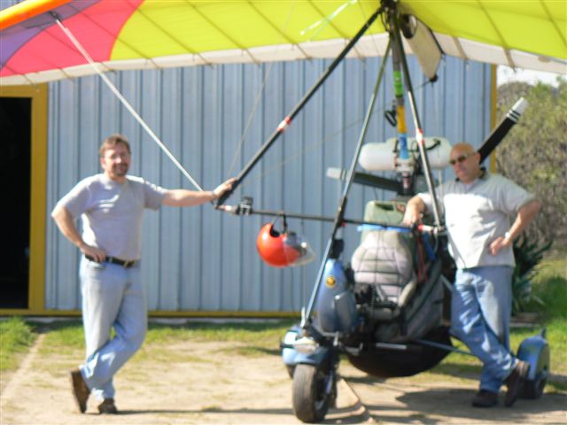

There is the mounting point, i.e. where you put the canister goes and then there is the cable attachment point. It is, as you suspected, insanity to attach the cable to the axles. Trike will invert on deployment and you are going to have to pray that your seatbelts keep you in place. The wing will no longer be flying so will not tend to remain at the top. To me the logic says, it must be attached such that the aircraft drifts downwards with all 3 wheels and suspension below you to help absorb the impact. Also it has to be attached in such a way that if you do have wing seperation, that the chute cable attachement point doesn't go with the wing. i.e. don't attach it to the hangpoint.
The canister must be mounted in such a way that the rocket going off doesn't hit anything like the wing, engine, prop or occupants. The other thing I have thought of is if the rocket goes off to the rear the cable under tension once the chute inflates will tilt the wing forward, i.e. nose down, and as a result the pilot will have the trapese bar pressed firmly into his chest or stomach at the full weight of the trike and it's occupants. I reckon this could be quite uncomfortable.
Speak to Abe on this forum he is the agent.
The pic is CLU-less's trike. HIs canister is mounted on above the motor. Skidmark can make up the mounting point out of Nylon if you ask him nicely enough.

Yesterday,
Who is that two sexy, slim guys standing there??
The Naked Trike

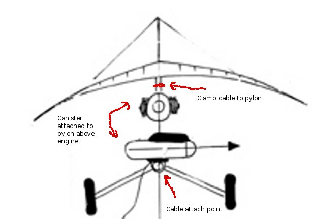

Thanks for all the inputs. I lifted a pic from the GRS manual to illustrate what has been recommend/what I'm planning to do:
1. There seems to be agreement that the canister is best attached to the pylon above the engine. I've got this in place already.
2. Also, there is agreement that the cable should be attached to the airframe, best at the base of the pylon. This is what I'd like to do.
3. The cable needs to be attached to the upper part of the pylon or around the hang-block to allow for a descent in an upright position. Since my cable is too short to reach all the way along the pylon to the hang-block, I'd like to opt for clamping the cable to the pylon above the canister as marked on the image.
GRS installation
Now, the last question is: what ready-made, available material (clamp, u-bolt, etc.) would be suitable for clamping the cable to the pylon?
The GRS manual indicates a 40-45 kN maximum force at various points of the cable. While I think that the clamp needs to withstand less, 45 kN seems to be a good reference value. What kind of clamp will keep a cable attached to the pylon in case of a 45kN side-ways force?
