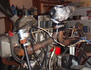

With fuel injection and a decent management system the motor will produce at least 80 hp and this we have proven in Jhb. without doubt. I attach pictures of the mock up exhaust and inlet manifold, these are for test purposes to "prove the system" and we will now cast the correct units in Aluminum. The throttle body is a Daewoo and the injectors are Bosch. I am trying to stay clear of any Euro sourced components as the exchange rate is against us. The electronics are local as air sensors etc,
So now I am going to complete the exhaust and send to Aiden so I can sort the paperwork and ATF etc. this will give about 4 hp alone, in the interim finish the patterns for the inlet manifold. Meantime I will fly with the exhaust then the ignition section then finally the efi installation. This will take some time (scarce at present) but it shows promise.
I have a budget price of about R10,000.00 for the kits and if the motor is imported without manifolds etc it should make a reasonable priced 70hp motor, as well as local parts.
The project has lost me a lot of flying so I am positive its worth it ! When its complete it will be available for someone to take over and market as we are rather busy at present !!

- This is a mock up exhaust and not for flying !!
- HKS exhaust.jpg (43.18 KiB) Viewed 1497 times

Hiya, I initially started this project last year when the knife was about to go into the 582, fortunately some good sense has prevailed. hence the real urgency to come up with a suitable alternative engine has lets say "dropped off". However I started the project and wish to finish it, obviously time is an issue for me but I have established that its a most worthy excercise.
The Italians turbo charge them to 93 hp so the engines integrity is not at risk, the HKS biggest downfall is it 1990s ignition system, (design not integrity), the rest of the motor is very rugged indeed. Hence the efi project makes serious sense.
I met Aiden today, he is obviously very interested as an alternative offering and the trike will go to him this week to finalise exhaust mounts etc. (also help my paperwork a bit !!).
So the answer is simple, its very early days but if you buy a standard HKS trike, get it fitted ex factory with a Zulu1 exhaust which is a simple "mod" a Zulu1 engine mount, oil tank and coolers and when ready it will be a simple matter of mounting the inlet manifold, butterfly body, fuel pumps and efi modules. The coils and engine sensors remain the same; no mods required.
After having flown the motor for a considerable period I admit missing the power of a 582 but now it has potential it makes a very viable financial and weight alternative to a 912. What the project needs is somebody with sufficient time to take it over and run with the ball...
The efi system that we have developed would also perform on a 912 and a Jabiru.
Oh and just one thing.. the technology is local (South African)...
Cheers Paul
