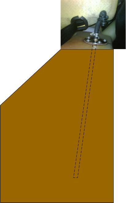

Trikenut wrote:How do you install the pick-ups?
Ross the pickups are metal tubes, either aluminium or copper, installed from the top extending down into the tank.
It doesn't matter if you install it before or after the pump

Thanks Morph,
When you say, "It doesn't matter if you install it before or after the pump" are you refering to the fuel filter?
