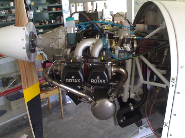

Slabfish
Posts: 416
Location: Jeffreysbaai FAPX
Postby Slabfish » Wed Oct 17, 2007 7:54 am
Hi Bennie , wees versigtig met daai taailpipe , die negentig grade buig moet liefs n ronde elbow wees , aangesie n 2 stroke exhaust baie fyn "ge-tune" is om die exh. gasse te help uit trek uit die engine en jy nou backpressure kan veroorsaak met daai (lelike) :wink: elbow,sal jy defnetief propbleme optel soos dit nou is. Moet asb nie my raad as negatiewe kretiek vat nie , maar dit is waarvoor jy die fotos pos ,nie waar nie , om posetiewe kretiek te kry. Ek hoop jy is gou weer in die lug, my hart bloei vir jou met al die probleme , maar ek beny jou passie vir vlieg !!!

Postby Morph » Wed Oct 17, 2007 9:05 am
Bennie,
the 912 exhausts come with a number of O-shaped rings of exhaust tubing. They look like donuts(the same size and shape). You then cut these to the angle you need and weld them in. I might have enough left from my exhaust installation to help you. I will look tonight.
Otherwise someone here on the forum might have or try aviation engines. A half ring will give you the 90deg bend down and the 60deg bend backwards at the bottom
Check the pic below, all the bends are cut from these O-rings
Postby Tailspin » Wed Oct 17, 2007 10:47 am
Agreed, exhaust needsome tuning and during the day I will go see some pro's on the toppic. It is just very hard to bend a 90 degree bend at a sharp angle, specialy with thin material. But I'll keep you all posted.
The spinner is a standard BB Spinner that Boet made with fiber glass and I send it for croming in Durban.
:idea: Bennie :idea: :idea:
Put fine sand in the pipe - this will stop the pipe from distorting when you bend it . :idea: :idea:
grostek
Posts: 898
Location: Dubai
Postby grostek » Wed Oct 17, 2007 6:33 pm
Hi Bennie,
Probeer om die klein binnekanste Buig in die pyp 2 keer die deursnee van die pyp te maak.
As die pyp 50mm deursnee is maak die binnekanste Radius 100mm en dan sal die Buite radius 150mm wees.
Dit sal n groterige buig maak wat die uitlaat gase nie te veel sal belemmer nie.

Postby Boet » Thu Oct 18, 2007 7:48 pm
Jis Benna, nou move jy darem. Ek kan sommer sien jou vlieg-lus sleep so op die grond. So vir die interessantheid: Het jy enige Boksburg konnektasies :?: :wink: Ek meen, eee, nou so met allie chroum goeterse aanie errie. Ek het nie geweet jy kan glasvesel ook chroum nie?? Wat jy ook al doen met daai "tail pipe" van jou, sorg dat die ding dunwand pyp is anders gaan hy jou knaldemper ( Ek meen jou ENJIN se knaldemper,) kraak. Jou olie-tenk kan nog so n duim of wat op skuif. Jou joppie lyk OK. :D
