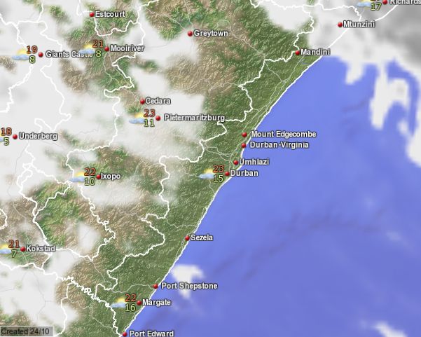

Hi James,James Bentley wrote:Not forgetting John Young's braai tomorrow at Light Flight![]()
Braai-day looking very wet.
Maybe we must fool the weather - get dressed early for work next week and jump in the planes and fly.
Will try and make smoke anyway.
John ZU-sEXY
- Braai-day looking very wet.
- Web2008_HiRes_Today_Over_Regn_52.jpg (55.23 KiB) Viewed 1363 times
