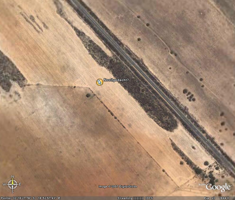

Postby Gyronaut » Sun May 06, 2007 5:47 pm
Where is Nooitgedacht? Google earth puts me in the mountains with the co-ords you have in your signature GR8-DAD?

skidmark wrote:GR8-DAD Johan has mentioned to me I should concider Canarvon flyin if I'm brave enough. I think you are on the way? But lets see how I go the next few weeks on my own got to build that foundation strong. :D
It's actually on the map you put up, zoom in, right next to the tarred N7 in a N/S orientation (east of N7). Speak to Morph as well, maybe he need a lift? fly up to Nooitgedacht and we all fly from here to Carnarvon :P

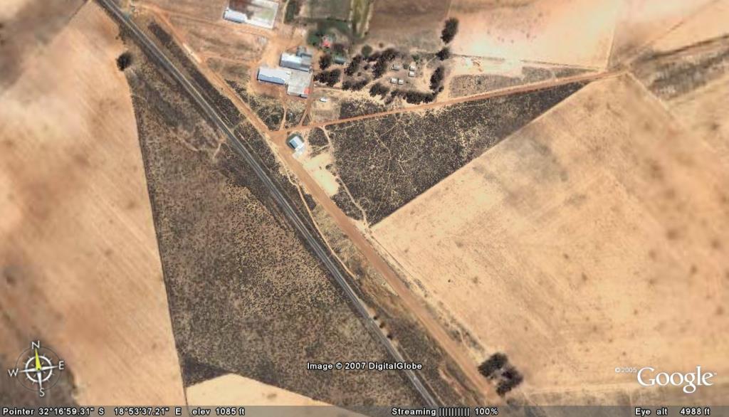

Postby Gyronaut » Sun May 06, 2007 7:11 pm
Is this it? I am very keen to go to the Carnarvon fly-in but it is beyond my range without refueling so I would welcome a 'pit stop' along the way. Is this the strip?
GR8-DAD
Posts: 700
Postby GR8-DAD » Mon May 07, 2007 7:18 am
Oops, Should be E 18 53 33. Here it is. More than welcome to stop over. Just give me a call beforehand to arrange for fuel, no problem.
S 32°16'49.8 E 18°53'33.0
Postby Gyronaut » Mon May 07, 2007 10:02 am
Aah, gotcha. Thanks! Looks great and I will definately be coming for a visit soon!
