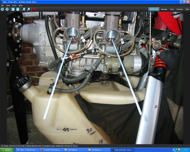

Have you tried synchronizing the carbs on YOUR aircraft as YOUR carb operating cables and splitter may well be be causing your prob,
The guy who posted this on the yahoo forum knows his stuff..... http://groups.yahoo.com/group/cgshawk/message/26176
I use a variation on his ideas with welding rods instead of drill bits...see pic....slightest moment of the throttle is shown with a twitch of a rod.
nick.

nickjaxe wrote:Have you tried synchronizing the carbs on YOUR aircraft as YOUR carb operating cables and splitter may well be be causing your prob,
nick.
Thanks for the effort, but as I said carbs checked, double and trple checked, which included synching and everything related.
