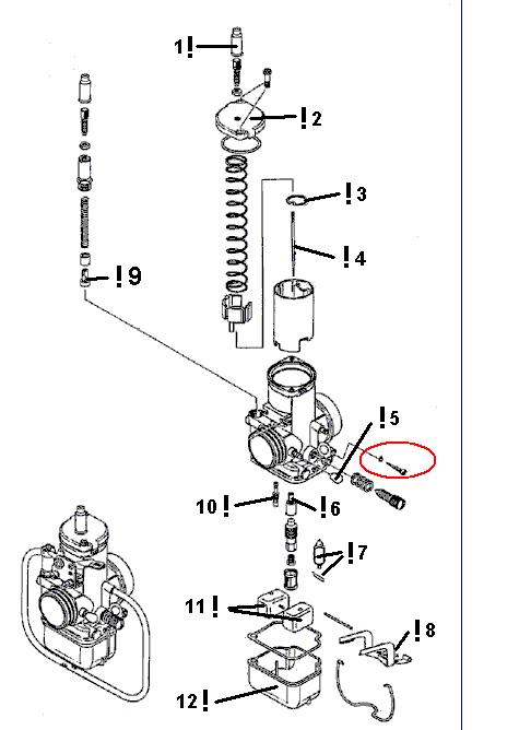

Alkemac wrote:The issue that I have is that the one that was usually lower, is now quite a bit lower. 525 degrees was the usual temp for the one, while the other was at 490.. It's now at 460 - and there doesnt seem to be any performance issues..
OK so the change is not on the hotter one, rather the cooler one. In other words that carb is running richer, suddenly. Check the plugs as mentioned. Are they burning black?
the only way the fuel mixture can get richer is if the choke (actually a fuel enricher) is not sealing shut properly. Check the image. Your choke cable lifts !9 to allow pure fuel to move from the float bowl to the throat of the carb. Could be leaking slightly and getting worse, now that the temps have dropped further

Thanks Morph - this is the first thing that I intend to do, when I get to the airfield -Wx permitting!
