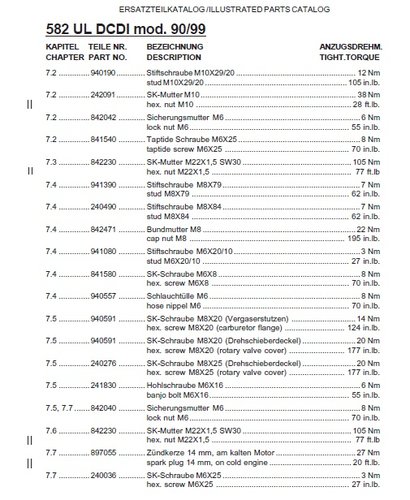

Hi Greg,
Do you have a workshop manual for a 582? Can you email it?
I have drained the rotary valve oil, and have removed the elbow.
After cleaning up the threads thoroughly on both surfaces, I have re-fitted it at the correct angle.
BTW, the specified Locktite is not available, but the importers gave me a suitable replacement. it is also violet in colour. I cannot remember the number. (It cost around R180.00 for a small bottle)

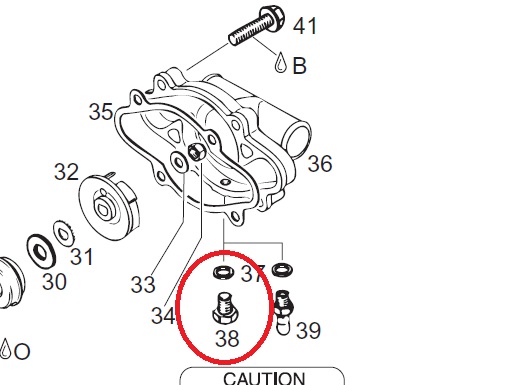

Anyway .... I want to tighten the drain plug for the rotary oil. Does the manual specify a torque setting for this?
I also need to tighten the nuts on the studs at the bottom of the engine. Is there a specific torque setting for this? (I don't want to pull the stud out of the crank case)

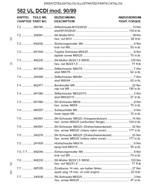

Postby Morph » Wed Nov 17, 2010 9:46 am
All the torque settings are in the illustrated parts manual. Huge 9Mb
Here is an extract
Studs are 940190,
The bolt is 841580
I am presuming you are referring to the bolt circled in red

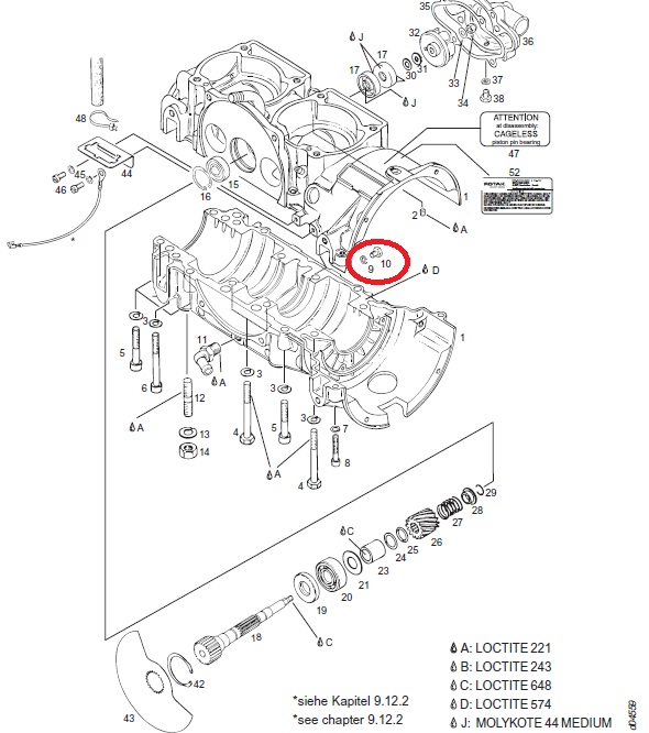

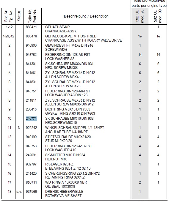

Postby bobthebuilder » Wed Nov 17, 2010 10:05 am
Thanks Greg,
Not that bolt. It's the one under the exhaust manifold. It has a copper washer under it.
Thanks for the last page.
Byron Kirkland
Re: Cracked Engine Mount and other issues.

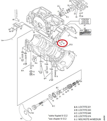

Postby Morph » Wed Nov 17, 2010 12:22 pm
This one?
There is no torque spec for it
