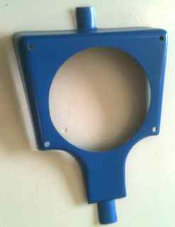

Braam, we have finalized the design and discussed with Craig (today) regarding the mod approval, at the development stages it was not possible to submit paperwork without a final operational design.
As we are all aware the fitting of Mode S transponders as mandatory fitment is on the horizon so its in all our interests to get this "right". It is designed to be as close as horizontal in level flight.
I have followed the Trig avionics installation as per specifications and used cables as per the mil spec stated.
The fibreglass dish (ally lined) with the ally ground plane is 850 grams and as per attached picture the device has adequate drain holes for fuel spillage, the device has been modified so that any chance of fuel retention is removed.
We remove the fuel gauge and mount the head in the panel, the fuel gauge is mounted in a single housing as fitted by street racing fraternity on the side of the pod.
Solo wings are working with us and will submit the required paperwork, we will be training the solo wings staff on the installation and programming procedures.
Unfortunately the Windlass is not an easy installation.
Paul
