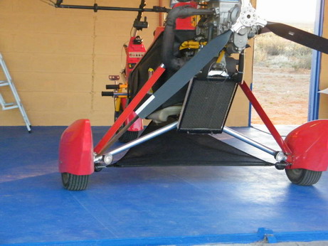

Question - is it better having the radiator on top of the motor or below the motor.
Mine is mounted at the bottom - Rotax 582 scout. Have a grit but need to put smaller mess on.
Getting stone chip damage - based on gravel strip - was thinking changing position to the top of the motor.
Is it worth the trouble (and paper work)

Hi Koevoet
Het selfde probleem op my Cobra gehad. Het 'n prop net soortgelyk aan die airborn trike sin opgesit en tot nou toe nog geen probleme verder nie.Beskerm sommer die prop ook teen klippe.
Groete
Gompou
