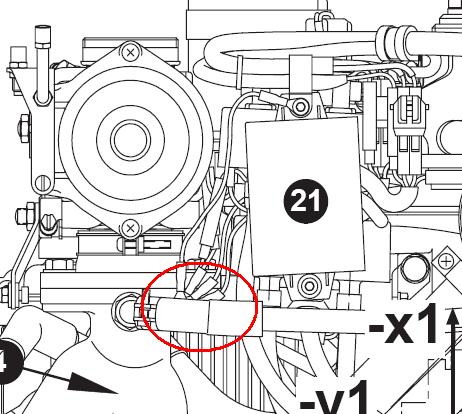

Oupa-G wrote:Morph the problem is only one earth that then becomes a single point of failure each ignition unit should have it's own earth. In the Bosvark we concentrate on the avoidance of single points of failure. Just a little snippet. Will see you at the meeting on Wednesday.
Cheers Oupa-G
Good point Oupa G. I will give them individual earths

Postby Morph » Wed May 27, 2009 9:04 am
Look at this exploded view of the ignition system taken out of the manual. Here you can see a single earth connection to both ignition systems as well. Based on my experience I would recommend this be changed.
I had a look at a 914 yesterday and it uses two different grounding points on the manifold. I only have one.

Postby Boet » Wed May 27, 2009 6:58 pm
Thanks for sharing this learning experience with us. I have 2 x 912 engines standing here, and yes, same prop. This will be changed. another day, another valuable lesson learned. (^^) Sorry I can`t make tonite`s meeting. Enjoy the company!! vhpy vhpy
