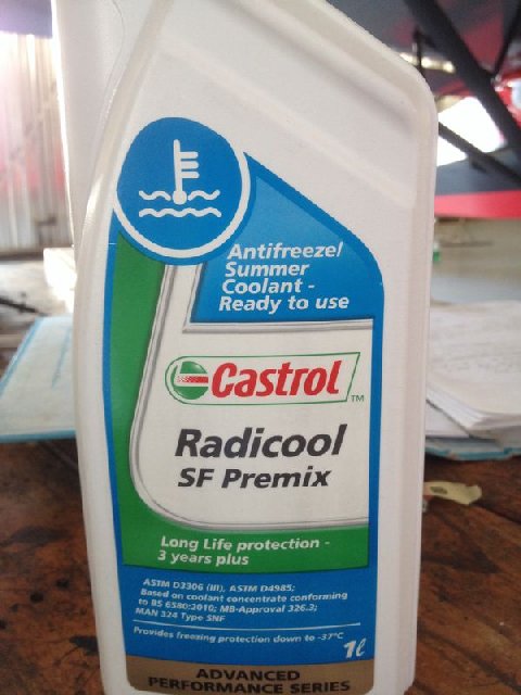

Ready Cool from Castrol, comes in a GOLD coloured bottle, Mix 50 50 with distilled water. Only the best for your rotax!

Boet, I assume you mean Castrol Radicool SF ?Boet wrote:Ready Cool from Castrol, comes in a GOLD coloured bottle, Mix 50 50 with distilled water. Only the best for your rotax!

Surely the Castrol premix should be fine ?John.com wrote:Make sure to get the 50/50 Prediluted Antifreeze & Coolant that is already pre-mixed with deionized water.
Re: 582 coolant ?
No problem RV.RV12 wrote:Surely the Castrol premix should be fine ?John.com wrote:Make sure to get the 50/50 Prediluted Antifreeze & Coolant that is already pre-mixed with deionized water.
