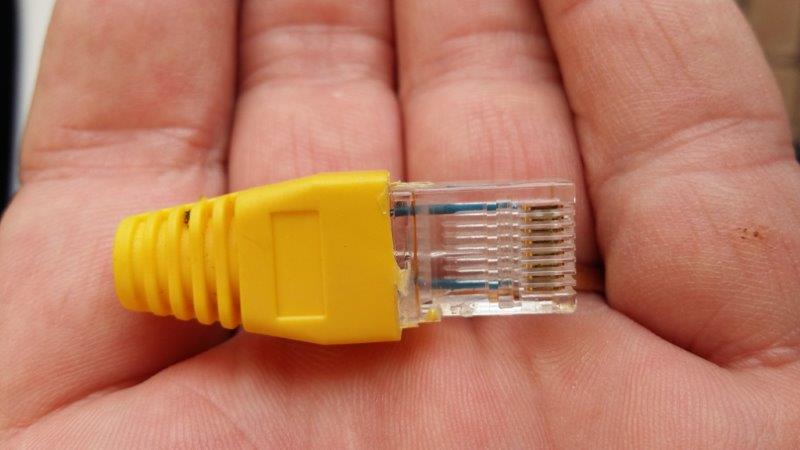

thanks guys..and must the pilot and pax headsets be plugged in for chatterbox to work?..sorry im new to this
Bulletjie
Posts: 409
Location: Rosslyn Microflyers
Re: Headset Issues
Postby Bulletjie » Wed Feb 10, 2016 11:02 am
Morning Jacques. Get yourself a plug made (or make it yourself) like this. Just bridge the two outer points and plug it in the chatterbox instead of the pax headset.
