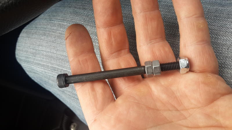

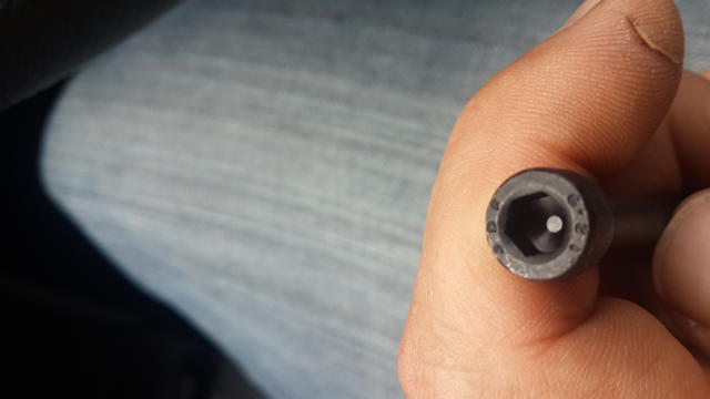

This is the correct cap screw. 12.9 HT
This screw plus Niloc = R3.90

Only use cap screw. 12.9 High tensile
Cadmium plated !
