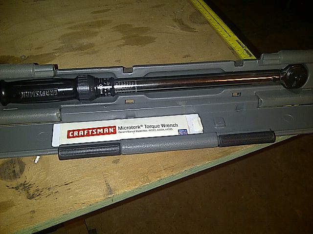

Hi guys.
Anybody have an idea where I can get a torque wrench calibrated? Its a small Craftsman, 10-75ft/lbs.
I found these guys and might give them a go http://www.torquetool.co.za/
Any other suggestions welcomed
