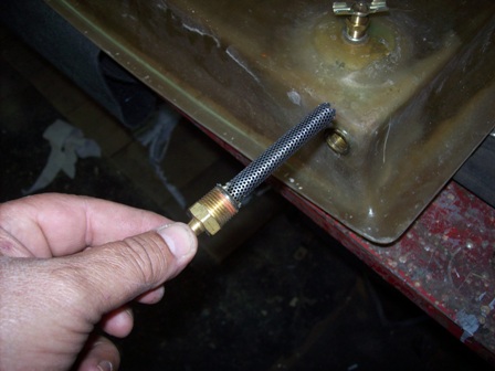

Not sure of the Aquila even has a strainer. They are usually installed into planes where you cannot look into the tank. You should be able to look into your tank and see any large debris in there like leaves. If take the take out and rinse it out
Re: PETROL FILTERS.......AGAIN!! But please look
Postby Bundy » Thu Jul 25, 2013 1:17 pm
Morph wrote:Not sure of the Aquila even has a strainer.
Yip...it does. :)
I only know because our tank was emptied and cleaned when we rebuilt ^
Postby Morph » Fri Jul 26, 2013 9:11 am
Excellent
Last thing you need is a leaf spoiling your day
Postby Boet » Fri Jul 26, 2013 3:48 pm
That is why ALL petrol tanks on aircraft should have a sieve at the petrol outlet point. That way "one leaf" can`t ruin your day!!

Mercedes Filter - the Best
ZU-BMZ
Aliwal North
Postby Boet » Fri Sep 20, 2013 10:27 am
And now I was told that the MB filter/sieve is no longer available, but fortunately the aftermarket part is still available, unfortunately, without "hose barbs". :roll: :roll: ## ## ## ## ## ## ## ## ## ## ## ##
