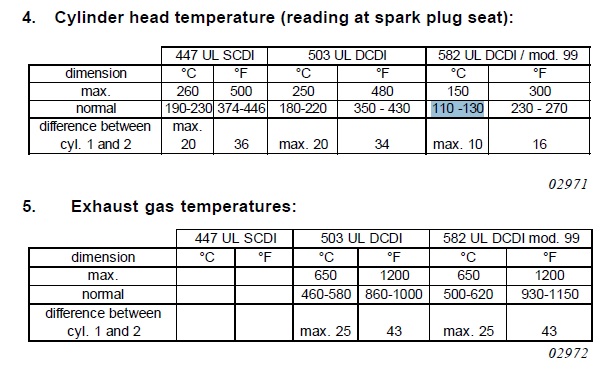

CHT is at about 110 degrees celius and the EGT's are both just above 500 at cruise and about 580 at takefoff.
Thanks
Is this a 503? Those temps are 582 temps

Re: Rotax 503 - Carb Needle setting??
Postby Morph » Mon Jun 10, 2013 4:54 pm

Bob this is the water temps
Martinvt
Postby Morph » Wed Jun 12, 2013 8:39 am
On a 582 you have a water temp probe on the top of the head, that measure the water temperature. 65 to 80 deg C is correct for this. If you want to read the CHT you need to place a probe on the head itself, usually around the sparkplug, or on one of the head bolts close to the spark plug
