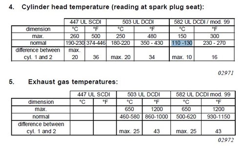

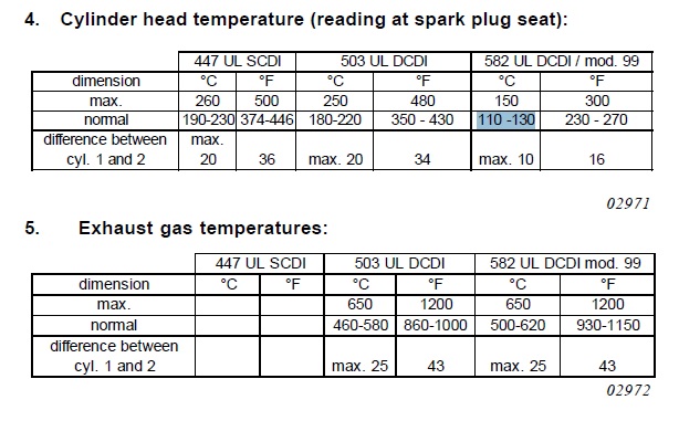

Is this a 503? Those temps are 582 tempsMartinvt wrote:
CHT is at about 110 degrees celius and the EGT's are both just above 500 at cruise and about 580 at takefoff.

Re: Rotax 503 - Carb Needle setting??
Bob this is the water tempsbobthebuilder wrote:CHT is at about 110 degrees celius![]()
CHT shoud be 65-80 deg C.
Interesting article here:
http://www.challengers101.com/ExhaustGasTemp.html

It was Morph who posted the Rotax excerpt.
I am still muddled about 503 & 582, and am getting my temps from the wrong source!
Thanks Morph for pulling this straight.
Byron Kirkland
On a 582 you have a water temp probe on the top of the head, that measure the water temperature. 65 to 80 deg C is correct for this. If you want to read the CHT you need to place a probe on the head itself, usually around the sparkplug, or on one of the head bolts close to the spark plug
