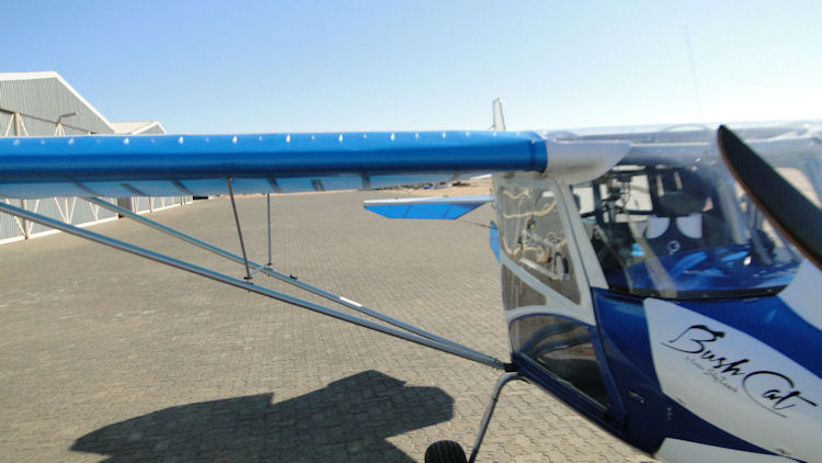

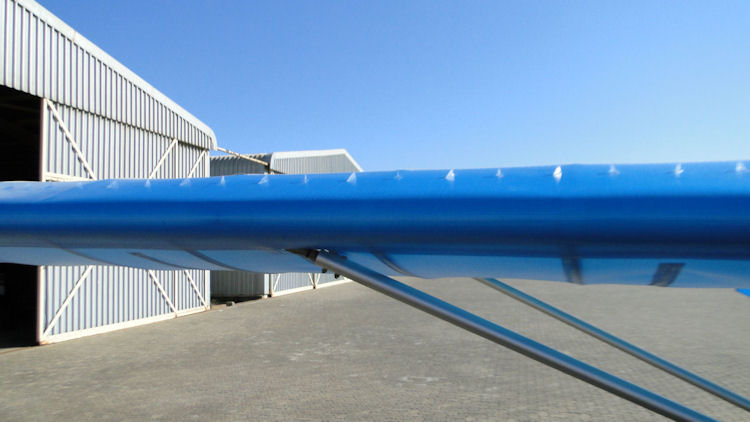

I fixed the VGs with clear silicone therefore I used the templates to draw the line with permanent black marker and then stick the VGs over. Quite a job. The amount of silicone on the VG must be right otherwise messy or not enough.
I'll take pictures and post them over the weekend.

Postby BushCat » Sat May 18, 2013 9:30 am
pictures of VGs
