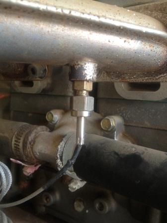

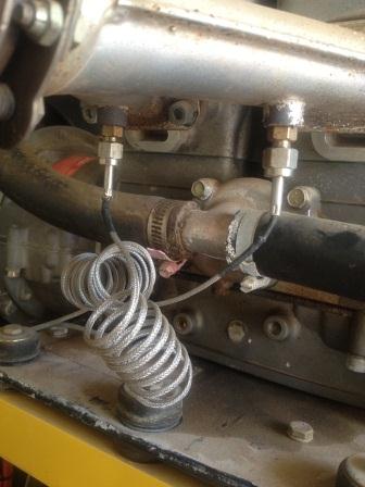

Postby cjkrit » Sun Mar 03, 2013 10:51 am
This is what mine look like.
