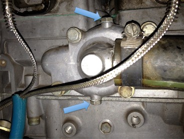

Here are some photos of the bleeding nipples, as my contribution to this post . . . .
Bleeding nipples on the water pump (directly under exhaust manifold) - top one to remove air (for cavitation), bottom one to drain coolant from system
Rotax 582 Coolant Bleeding Nipples - Water Pump.jpg (44.56 KiB) Viewed 8877 times

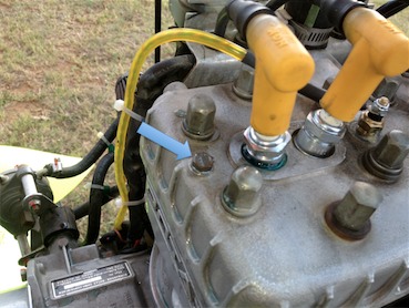

Bleeding nipple on cylinder head - to remove air from cylinder head
Rotax 582 Coolant Bleeding Nipples - Cylinder Head.jpg (48.87 KiB) Viewed 8877 times

I have a simillar temp problem on my 582 blue top..... had a look on the waterpump for the bleeding nipples this weekend. Only have the bottom one and not the top one :?: :?: :?:

Sad-Ham wrote:I have a simillar temp problem on my 582 blue top..... had a look on the waterpump for the bleeding nipples this weekend. Only have the bottom one and not the top one :?: :?: :?:
Hey Sad Ham!
I can only assume that the design change (to blue top) has resulted in the top bleeding nipple on the water pump being done away with. I would not worry, although, as always, it will be best to seek some professional guidance.
