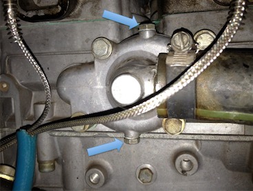

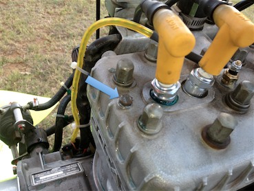

Here are some photos of the bleeding nipples, as my contribution to this post . . . .

I have a simillar temp problem on my 582 blue top..... had a look on the waterpump for the bleeding nipples this weekend. Only have the bottom one and not the top one
Aquilla II ZU-DJS
Wingfield - 124.8
Wingfield - 124.8
- John.com
- Posts: 1288
Re: 582 Water Temp.
Hey Sad Ham!Sad-Ham wrote:I have a simillar temp problem on my 582 blue top..... had a look on the waterpump for the bleeding nipples this weekend. Only have the bottom one and not the top one![]()
I can only assume that the design change (to blue top) has resulted in the top bleeding nipple on the water pump being done away with. I would not worry, although, as always, it will be best to seek some professional guidance.
