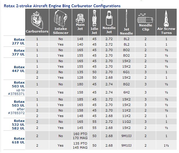

Re: 582 Blue Top Main Jet Size ???
Try this site, it seems to have all the answers.....If not Morph or Duck will be able to help.
http://www.ultralightnews.ca/bing/bingjetchart.html
Later

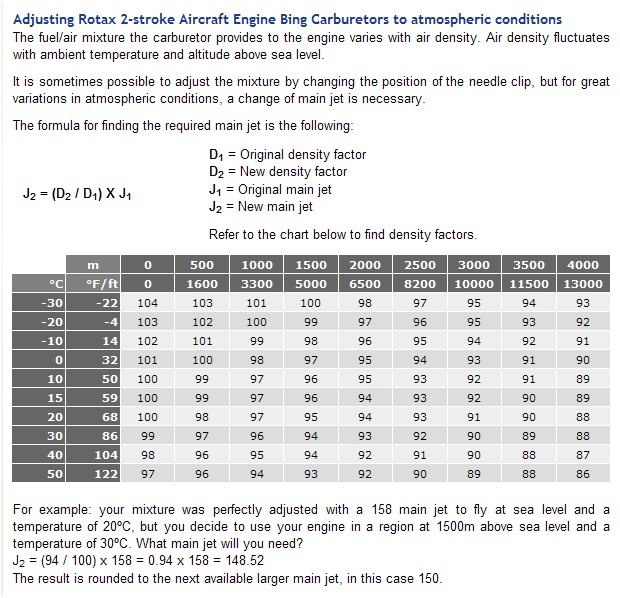

There's a possibility that, IF something happens and you prang the plane, the AP may turn around and say that he signed it out with 165's and now there's 158's in the carbs? Your Insurance MAY not pay out.Raymonvt wrote:Thanks guys, I will not want to start a war here![]()
Fit the 165's, get it signed out and then put the 158's back?Is this ethical, both uses the same needle.
But you don't have to go that route. Your AP really doesn't know what he's talking about
Refer him to the following chart and if he still doesn't want to sign it out then get another AP.
The example given in the chart is for a size 158 at sea level (Rotax 503). Just apply the numbers for the 582 and get the correct answer
Example: I would say 5500' at 25 deg C = 94.5 (D2) and 0' at 25 deg C = 99.5 (D1)
Now D2 divided by D1 = 0.9497 x 165 (main jet at sea level) = 156.70 rounded off to the next higher available main jet = 158

And here's all the jetting and needle sizes for the different Rotax 2 strokes AT SEA LEVEL
