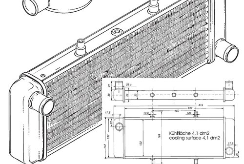

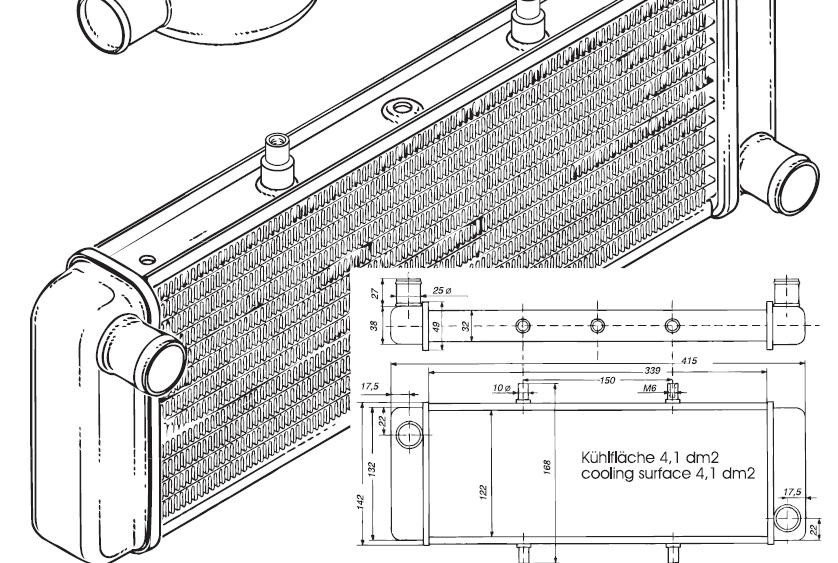

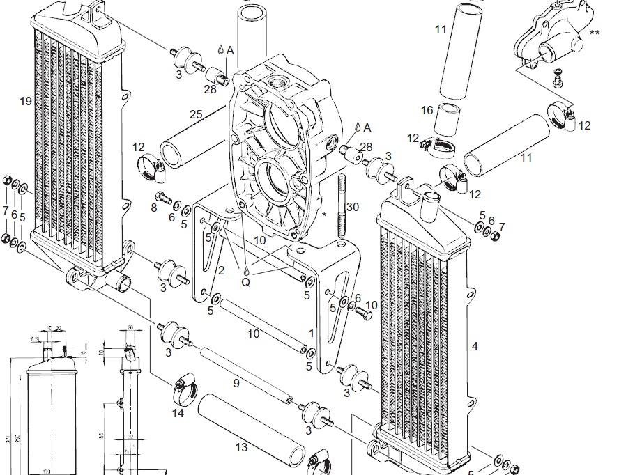

JohnCWE wrote:It is an inverted blue top engine and the engine is above the radiator, actually the radiator is across the center front of the engine, it is mounted up against below the gearbox and is higher than the cylinderhead but lower than the pump, a standard long thin rotax radiator
Hi John,
when you say standard long thin radiator are you talking about the one in the pic below. If that is the case then this radiator is way too small for a 582. These are used for 912, because only the heads are water cooled, hence the small size. Most trike installations I have seen use two small or 1 large radiator. The 912 radiator's cooling area is 122 X 339 mm = 41358sq mm. The dual radiator installation is 109 X 290 X 2 = 63230 sq mm. Most fixed wing, closed cowling installations use VW Golf radiators
when you cut the engine to idle for the decent, and touch and go, the engine will cool quite quickly, hence the seemingly low temps on the ground. If you sat still on the ground and ran the motor at full throttle you would see much higher temps.

I have the 2 small radiators and one large radiator on my Skyranger with a 582 and temp stays at 80deg in very hot days.The large radiator is situated behind the motor and have never had any prob.
