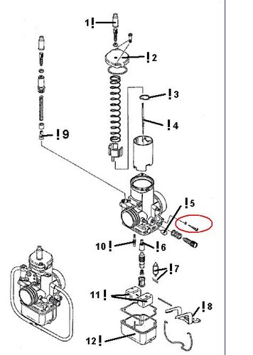

You idle setting should not have any effect, unless the motor is idling very low and the jets are set very rich.
You say she only starts with the choke open. Once started do you close the choke all the way? Does this change the tone of the motor?
Your choke is not a choke it is a fuel enricher. It routes pure fuel past the jet stage from the bowls to the throats of the carbs. Perhaps it is cracked open just enough to smother the motor at lower revs but not enough for higher revs.. However once the idling is set higher, the motor has enough power/inertia to rev past the smothering stage and then rev to full.
See the pic. !9 is the choke jet, it has a flat surface that needs to mate with a surface at the bottom of the tube. Below that you will see a tube that extends into hole in the corner of the float bowl. This jet is adjusted by the choke cable. Make sure that when closed there is a bit of play on the cable. Otherwise take the whole assembly out and check the condition of the jet. The flat surface of the jet could be worn resulting in it not sealing properly.
The float bowl is a chamber of liquid subject to fluctuations in air pressure, now assuming the air pressure was higher when the motor last ran, and the following day the pressure drops, the higher pressure in the bowl will try and force the fuel out. If the choke jet is not sealed, fuel will be pushed up the tube and into the throat, hence the evidence of fuel being found in the throat of one of the carbs. I suggest this is the carb where the choke is not closing properly
