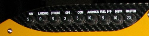

Where can I get pop out fuses? Are they called pop out fuses?

Are you refering to Circuit breakers rather?
You can get these from Aircraft Spruce, or order locally through Placo.
http://www.aircraftspruce.com/menus/el/ ... akers.html
http://www.placo.co.za/index.php?option ... &Itemid=36
The Klixon are the push pull type which are a little pricey @ $22 each, but they work well.

Considering that they are reusable, it's worth it, especially when far away from a Midas

Any idea of what these fuses / circuit breakers will cost locally?

Phone Placo, they will be able to quote you.
Assume they will add tax, import duties(if they apply) and mark up, so you are most likely looking at around R220 to R250 each

No way!!clive layland wrote:Phone Placo, they will be able to quote you.

CB's look very professional, but are VERY expensive. For the average micro/light aircraft, rather use the normal glass fuses. Always have some spare fuses in your flight bag.
Remember, if a CB pops, or the fuse blows, DO NOT just reset the CB, or replace the fuse!! There is a reason for the interruption in the circuit. FIND THE PROBLEM.
The latest trend in airliners is that if the CB pops, don't even try to do a reset, specially in the air, and a reset should only be considered if the equipment is of vital importance. For us flying in VFR conditions, resetting a CB/changing a fuse in the air can be expensive, and outright dangerous.

You are reading my mind! Why reset if it pop the first time. Land and inspect...and much cheaper!ZAZU wrote:CB's look very professional, but are VERY expensive. For the average micro/light aircraft, rather use the normal glass fuses. Always have some spare fuses in your flight bag.
The latest trend in airliners is that if the CB pops, don't even try to do a reset, specially in the air, and a reset should only be considered if the equipment is on vital importance. For us flying in VFR conditions, resetting a CD/changing a fuse in the air can be expensive, and outright dangerous.
Think twice, do once....
...still...can I cut buget if I'm up in the air...?

or you can get them here RS Online [RSOnline.za@online.rs-components.com]
look for resetabble fuses and for the rating and voltage you want.

Thanks for the info, but this is what i got..Stephan van Tonder wrote:or you can get them here RS Online [RSOnline.za@online.rs-components.com]
- resettable fuses.jpg (5.21 KiB) Viewed 2859 times
