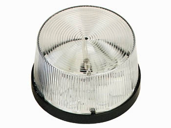

The previous owner of my gyro fitted 2 of these security alarm type strobes:
As they are not very effective, I thought I'd upgrade to a pair of these LED strobes:
Prior to installation I tested the new LED strobes using the existing wiring & switch etc (i.e simply swapped the old strobes with the new) and found that with the new LED strobes I hear a constant "tick tick...tick tick...tick tick" clicking sound interference through both the pilot & pax headsets :x (irrespective of VHF radio being on or off).
