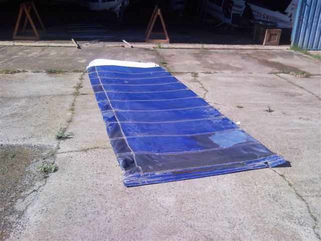

The strip down.

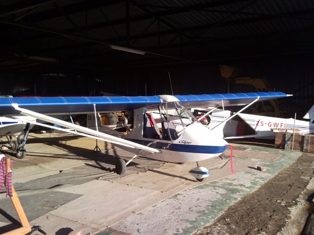

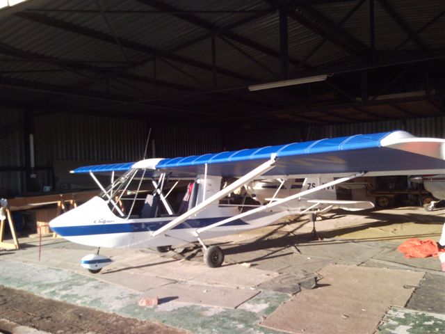

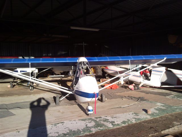

Need to take a couple more photo's but this is what I have at the moment now she's completed.
