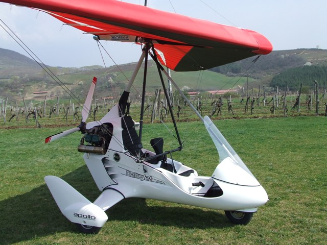

I'm in the process of purchacing a Rotax 912 UL(80hp) engine. I need to customise the exhaust pipes to fit the specific trike. The exhaust must look like these in photo attatched. Question : a)Is it possible to make these changes without affecting the performance of the engine b) If so, who can do it for me.?
At this moment the exhaust pipes are longer, but I want to change it to the lengths of the pipes in photo attatched.

Install the motor in the trike, take the wing off, take the trike to an exhaust place. I used Cowley
Re: Rotax 912 UL exhaust
Is it that simple?. Do the lengths of the pipes effect any performance??

A 4 stroke is different to a 2 stroke. 2 Stroke engines need a tuned exhaust.
Are you buying the exhaust from Comet? They will ship you a silencer, some circular doughnuts and some straight pieces. The exhaust guys cut and match to get it to fit. Any performance exhaust place will be able to do it for you. I literally installed by engine on it's engine mount and took the whole lot to Cowley. I told them what clearences I needed and viola a perfect installation. Remember the exhaust headers get to 800degC make sure they stay clear of any plastic, water or oil pipes and wiring.
Hi Skin
On a 2 stroke the length is critical as mentioned. On a 4 stroke it is less of an issue but it will change your performance. Normally the peak torque is shifted up or down in the rev range. The volumetric efficiency (VE) is also changed. The implication of the shifting of the VE is that the fuel at the different rev ranges should be changed. In the case of a 912 it is designed to run rich so you will probably be OK if the change is not radical. Keep a careful eye on your EGT's after the change because if it is to lean it will overheat ....
It might influence your fuel consumption so it will be interesting to let us know how much difference it makes. I would also be very interested to know the difference between the EGT's of the front and the back cylinders. If other 912 owners know the difference on their front and back EGT's please post it for comparison. (I am busy experimenting with a 912 fuel injection and the difference between the front and the back is about 100 C which is way out to much)
