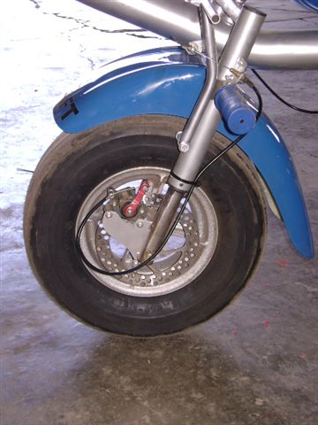

Looking to put disk brakes onto the front end of an Aquilla. Anyone done this before if so, do you have pictures and price or have a name of the contact that could help me with this. (this is to help on those extremely short field landings)

I am not sure if the Aquilla front wheel suspension can cope with the forces of a disc brake.
For good stopping power you would want rear wheel disc brakes.
A friend of mine built rear wheel brakes for the Aquilla. He built the prototype, which unfortunately had some design faults. I am not sure if he will continue with the project.
I would be interested in fitting main wheel brakes. The nose wheel is a weak link in most aircraft with a tricycle undercarriage, and I would try to reduce the forces on it.

Hi,Arnulf wrote:I am not sure if the Aquilla front wheel suspension can cope with the forces of a disc brake.
Arnulf makes some very valid points.

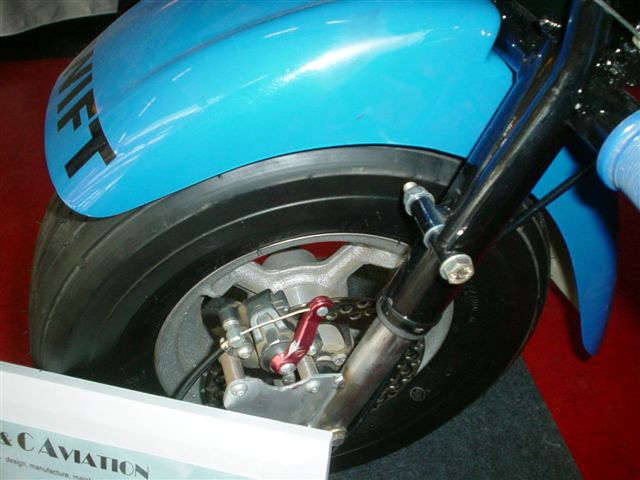

Below photo's of a front disc brake assembly.
One of my hanger buddies Jan is busy installing rear disc brakes on his Aquilla. Batman - let me know if you want his contact details.

- DSC03704.JPG (52.43 KiB) Viewed 1611 times
- DSC00277.JPG (39.91 KiB) Viewed 1611 times
