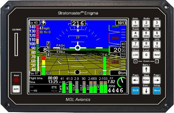

It seems like a lot, but this is what you will pay for a Digital all in one MGL Stratomaster

hehehe, install that one right and the steam gauges left. Actually I must say I do love steam gauges

I think go for the MGL, i know a guy that had it installed, says it works great!

Steam gauges will be in keeping with your radial engine..... The Enigma will make using her a lot easier....
What about Morph's (I think for EPH?) idea of installing the Enigma behind a closable "cubby" hole. You then have the classic look but you get to open the door to the GPS when you're lost........

Enigma my first choice, but there is some resistance... My thinking is it a new radial, and hus deserves a new panel rather than a old(classic) one...

Am I right in saying that one instrument replaces all the others? Makes sense to buy if it is (5c?).

Quite right Uncle Spud, downside is that if it pops in flight you have NOTHING. Another downside is that its complex to use and takes a while to master whereas the classic 'steam guages' make immediate sense to anyone that flies the machine and reduces the pilot workload drastically. I for one have always been in two minds but opted for steam gauges when I had the choice in my machine.Uncle Spud Murphy wrote: Am I right in saying that one instrument replaces all the others? Makes sense to buy if it is (5c?).
World class glass panels are manufactured and exported from SA by the container load (right here in the Cape) so there must be a huge demand for them although I seldom see them in use in the microlight fraternity here.
I am keen to hear the opinions of the 'informed' here.

Dead simple to use. It a bit like a computer. Huge capability which few understand or utilise fully. It gives far more info than the steam gauges, but you can customise the display to give you just what you want. Installing and configuring is far more complex than steam, but not impossible...
Takes a couple hrs once installed to get to know. I think main reason there are not many in ML's here is that they are all VFR machines and given the cost of the glass cost benefit arguments are valid. USA glass is far more expensive that the local version.
Most add a GPS to steam in any case. Here it all in one. Does not change the way the plane flies and they have redundant systems (2 batteries, some even 2 +internal backup to give 2hrs without external power). If it all goes dead you should not have a huge problem. During one of my renwals the instructor covered the whole dash and made me land without airspeed, alti or any other instruments (He was a tiger moth driver and said VFR ment you must look outside and feel the aeroplane). After getting over the initial shock it was not tough at all...
my 2c...
