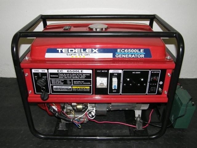

Received an advert for one of these at R6000 for a 5.5kVA generator. But the company is JHB based. It gets wired into your DB board for approximately R3300. Put a UPS on your PC for approx R800 and then run to the garage and flick the switch to turn the generator on.

- 5.5kVA Generator.jpg (51.18 KiB) Viewed 2595 times

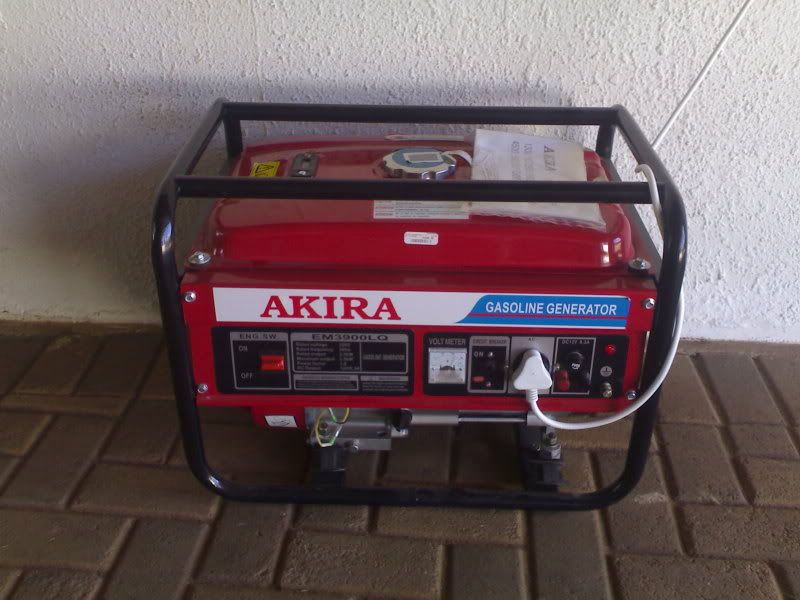

This 3kva one from Mica for R3500 discounted to R3000 for CASH... (That before the 12 days of darkness (as opposed to the 12 days of Christmas)
