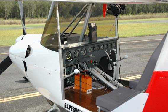

I have flown one and they are great planes.
I like
the width of the cockpit is nice and wide, there is a centre console that further ensures you are not rubbing shoulders with the PAX.
They fly easily
They are built well and will last for many years if looked after and hangared (particularly the Dacron version)
Visibility is great
I don't like
They believe thay have a problem with adverse yaw, which again I believe has been solved using a large fin under the tail to increase the vertical stab surface area. The version I flew had extra vertical winglets on the ends of the horizontal stab and the extra fin underneath as part of a factory controlled test which definately did help. (adverse yaw means you have to live on the rudder to remain in co-ordinated flight. If left alone the fuse tends to skid left and right, depending on which side of the fuse is generating more lift. In a turn the tail can easily oversteer requiring some opposite pressure on the rudder to quickly bring it back. Also on landing you have to be very active on the rudders to maintain runway lineup.)
I think they are a little overpriced
I don't like to look of the laced on Trylam/Dacron
I am not crazy about the single center joystick
The Cheetah was my other choice when I was looking at building buying. The cost of the BB swung me in it's favour, although I would have been up in the air much quicker with the Cheetah as the kit is a fast build requiring only about 150hours instead of 650hours.

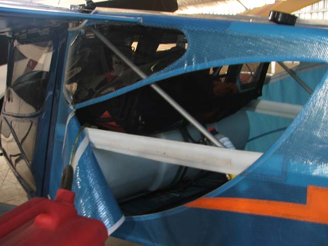

- A closeup of the luggage bay

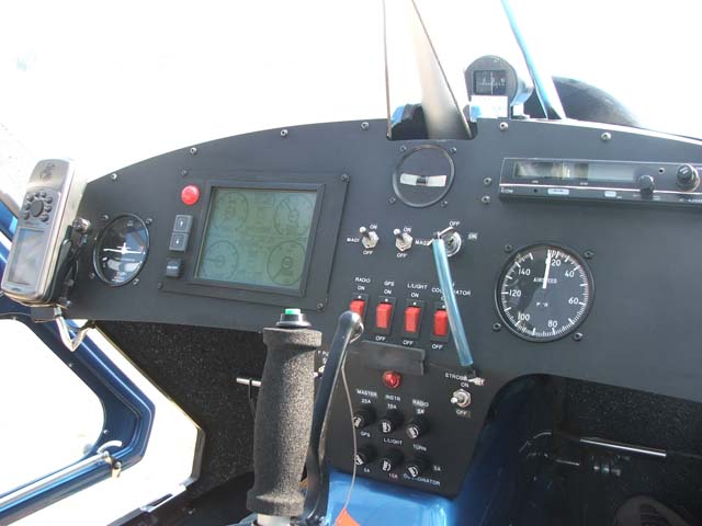

- The Dash
