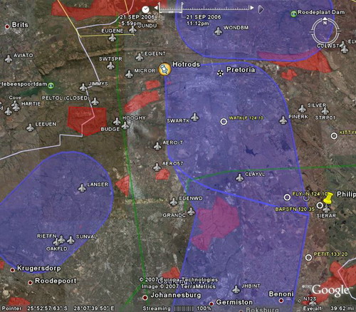

Demon, thanx for the advice.
Big D, looking at my Google earth pic, would you use the Pinedene route from Siera Romeo to AP through Waterkloof or would you squeege through between Waterkloof & Wonderboom?
You're good at this, so please help me quickly with the correct radio procedures all the way to you & maybe I'll visit over weekend. I'll get used to this as I visit further & further. Up to now has been mostly around the patch for me in the MXII.
I know there's a similar thread, but I want a procedure that's specific for this flight.
Regards,
Henni
- To AP small.jpg (95.56 KiB) Viewed 1854 times
Maybe this says it all:
"Enter the FAWK CTR south-east of Microland airfield when flying from the east. Stay clear of the FAJS CTR. Contact FAWK on 124.1.
The biggest problem usually is that pilots do not know the correct radio procedure and then gets on the wrong side of the ATC. As always, knowing what to expect and what to say will make it a lot easier. The conversation will go something like this:
Pilot: Good morning, Waterkloof. This is Microlight ZU-ABC.
ATC: ABC go ahead.
If the ATC is busy he will reply and ask you stand by. Once he has acknowledged you, your reg is written down on the log so he won't forget about you.
Pilot: Microlight ABC, 2 on board, enroute from Petit to Hartebeespoort dam. Currently at the CTR boundary in the Bapsfontein area, altitude 5500 ft. Request routing via Pinedene for Hartebeespoortdam. ABC.
ATC: ABC routing approved. QNH 1021. Remain at 5500ft or below. Report overhead Pinedene next.
Pilot: QNH 1021, 5500 or below, report overhead Pinedene next. ABC.
You'll most likely be routed at 5500ft or below which is about 500ft AGL. Keep an eye out for the power lines that converge east of Pinedene station.
Pilot: ABC overhead Pinedene at 5500 ft.
ATC: ABC report outbound approaching Ultra City Next, remain 5500ft or below.
Pilot: Report outbound approaching Ultra City next, 5500 or below. ABC.
Pilot: ABC outbound you CTR at 5500 ft.
ATC: ABC contact GC on 122.8 . Goodbye.
Pilot: Thank you sir, goodbye.
Pilot: Good morning, Grand Central. This is Microlight ZU-ABC.
ATC: ABC go ahead.
Pilot: Microlight ABC, 2 on board. At the Waterkloof CTR boundary approaching Ultra City, altitude 5500 ft. Request routing for Hartebeespoort dam.
ATC: ABC cross the extended centreline of rwy 35 at 5500ft. Report overhead R28.
Pilot: Cross the extended centreline of rwy 35 at 5500ft. Report overhead R28 next. ABC.
Pilot: ABC Overhead R28, 5500ft.
ATC: ABC transmit on 125.8 in SRW. Goodbye.
On the return trip contact GC first and expect to be routed at 6000' usually. If there are other fixed-wing aircraft on the route already, you'll get a lower route."
Only question remaining: Would you use this route or rather fly through in between Waterkloof & Wonderboom?

Go Pinedene and if FAWK is unmanned, broadcast your routing. Call inbound Pinedene and Outbound at Ultra City. Woolworths has just completed a new distribution Centre (big Wollworths sign on side) which is easy to see from miles away just East of the ultra City. I usually call outbound there and this gives FAGC time to respond before I barrel through the extended centreline of 35. Also if FAWK is unmanned, call if you hear anyone else on the route and confirm their QNH is exactly the same as yours else can be a bit
when you get close together. Separation will usually only be 500'. Also watch for traffic in and out of Fly Inn & Kitty, but they should be on same Freq...
The Pinedene station is a bit tough to see when the smoke is bad. I route just to the N of the power lines and call overhead the railway line running N/S if you can't see the Pinedene station..
Enjoy it...

Pinedene route is quick and easy, between Waterkloof and Wonderboom, you mean over Swartkop? Normally the routing that way is over the mountains so south of WB and via Kitty Hawk, Mamelodi.
My aircraft flies pinedene like others fly downwind on their home airfield, stupid auto pilot.

Yeah, good advice from George
If Waterkloof unmanned don't do as DH and I did: (Flying from Petit to AP)
We called Waterkloof tower. Nothing
Tried again: Nothing - Oops, must be something wrong with radio so we routed past Cullinan to get home to AP - Twice as far :D Radio started working again on route to Cullinan
Finally get home, phone Demon - Tell him radio was broken there for a while, no he says - Tower was unmanned
If nobody answers keep broadcasting your position - Can do radio check with Central Radio on 122.80
