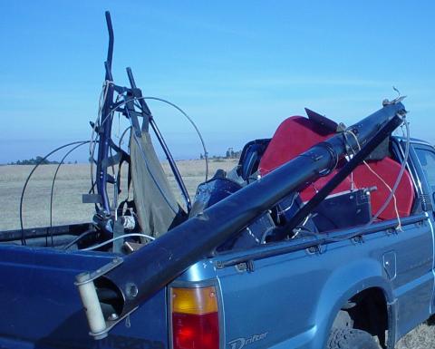

The Flight Star shown in the back of that bakkie. Pilot had 2 engine out and landed safely. Could find absolutely no reason for the engine outs on the ground – started and took-off again. For peace of mind, he installed a new 503 because nobody could explain the 2 engine outs. 15 flying hours later pilot writes off plane. I saw him loading it onto the bakkie and asked if he had the same “glass thingie” with the other 2 engine outs. Of course he did. :shock: :shock:
