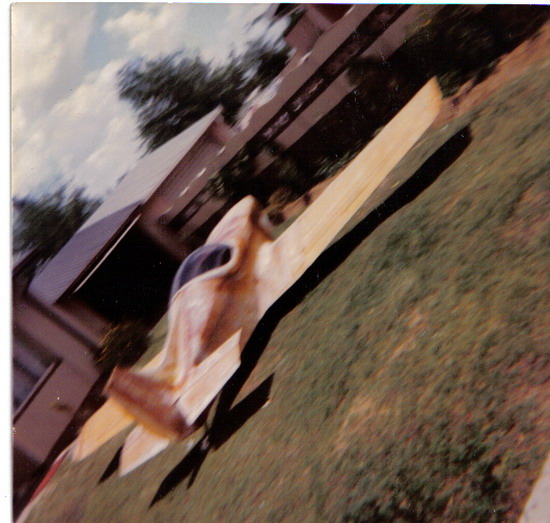

Hi Willie,

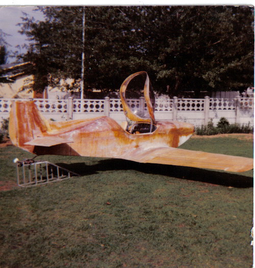

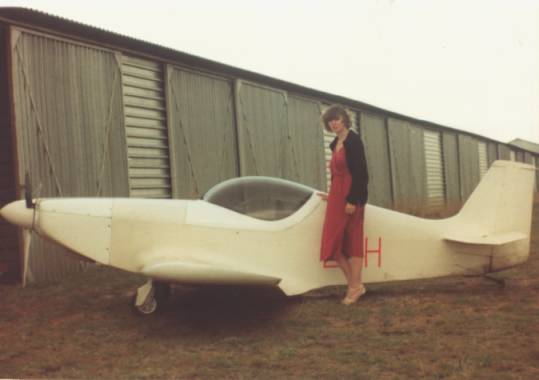

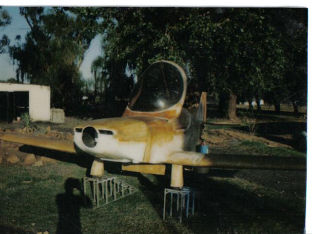

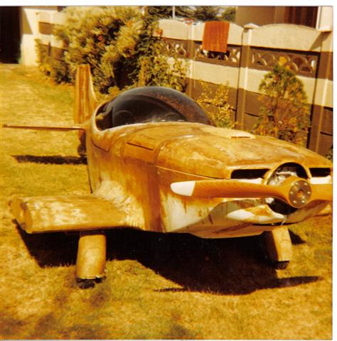

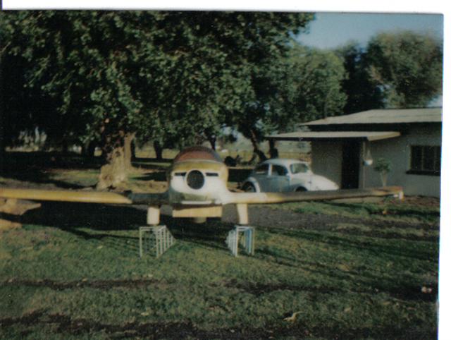

Herewith the pics requested. Best I could find describing my comment for now:
Please note: We did not have internet or websites back then. So the the pics were few an far in between. These might not be the best pics and the aircraft was still very rough on the outside as I was busy with finishing touches whilst also doing some testing at the airfield.
But they do show the carburator scoop and belly brake. The belly brake was fabricated by building a square section with 5/8 X 5/8 stringers (same as the side longerons) and boxing on both sides with ply.
I made very, very strong hinges from aircraft aluminium and attached thoroughly behind rear face of forward main spar. The handle is a thick wall aircraft aliminium tube bolted straight to the brake - no flimsy linkages in between. This meant that you could apply any amount of desired brake at any given time.
The load on the handle at 85mph was low enough to handle with ease & I was totally satisfied with the whole concept.

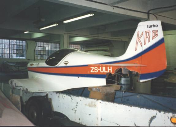

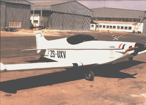

Henni,
I think this is a photo of your KR when it was completed. I believe it did fly but was quite heavy so the owner began rebuilding the wings (removing the tanks). As far as I know the mod's were never completed and she never flew again. Funny thing is I purchased some KR bits and pieces that included some wings with large holes cut in them. The reg number was incomplete but the first two letters where the same as this reg number, I'm using the spars for the KR1 I'm busy rebuilding.

Hi Flykr,
Yes, that's her, the reg no. is now absolutely familiar. But she looks completely different. Can definitely recognize her by the shape of the canopy, only thing that's still the same.
I am very, very tempted to purchase the partially completed KRII being advertised her. However, we just bought a new house and my wife might be too keen on the idea.
I must say, that value for money and time required & cost to built (if built strictly to plans), very few aeries would beat the KRII.
Thank you for the update - pity she did not take to the sky. I would definitely have flown her regularly if I had the opportunity to complete her.
Regards,
Henni

Henni I like the camo couler sceme of your first pic it totally blends with the lawn.
