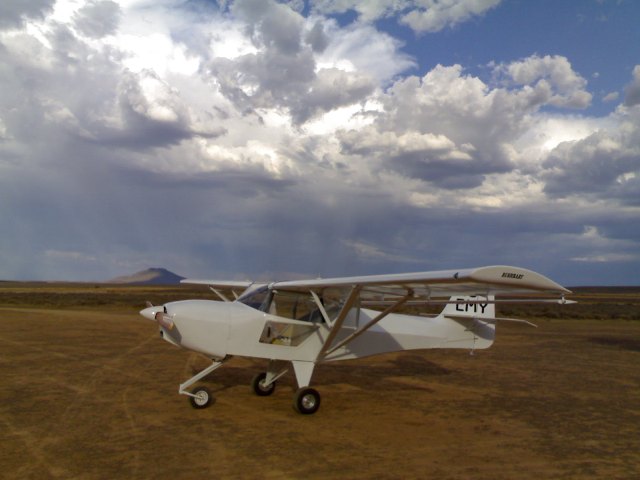

Nosewheel Bushbaby???
Don't get me started, I type to slow............. :lol:
Nottaquitta
Postby Boet » Mon Jun 04, 2007 7:29 pm
Mogas, die lyk darem ook maar MOOI ne? :roll:
ZU EMY.jpg (45.52 KiB) Viewed 2054 times
Willie
Posts: 463
Location: Phalaborwa
Postby Willie » Mon Jun 04, 2007 7:36 pm
Boet wrote:Mogas, die lyk darem ook maar MOOI ne? :roll:
Amper soos 'n melk stoel :twisted:
