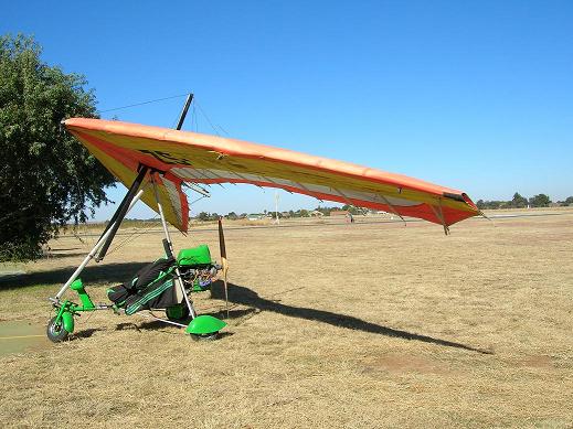

Thanx for the info man, im looking to spend between R40 000 and R60 000. being my first trike, im not looking to spend a lot of money but was wondering if there is anything out there in that price range. I guess its pretty much preference hey?
If u dont mind, can i ask some more questions??
How many hours is a lot for a trike?
Im only around 60kg's so what size wing do you recommend?
I also had the option of buying a windlas, with a cosmos wing, aquilla suspension, and full instrumentation. The wing looks a bit old in the pic though.... for R45 000.... what do you think??

I would suggest you get an AP to check out the trike before you get suckered like i did. :shock: (Two years and still repairing "SMALL" things) Not that all sellers are sharks but there are some out there. The trike looks cool, i would have a close look at the wing as that is one of the more inportant parts but ultimately the end decision is yours to make.
