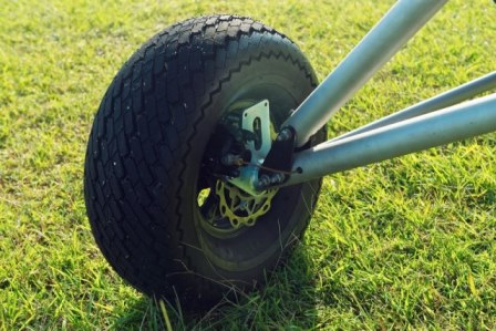

Herewith are couple of pictures from Indonesia:
Front fork with master cylinder and new brake pedal.
Old mechanical drum brake is still attached and works.
Rear wheel with calliper and brake disk.
We use copper pipes for hydraulic harness to increase reliability.
Only short piece of plastic pipe next to front fork.
