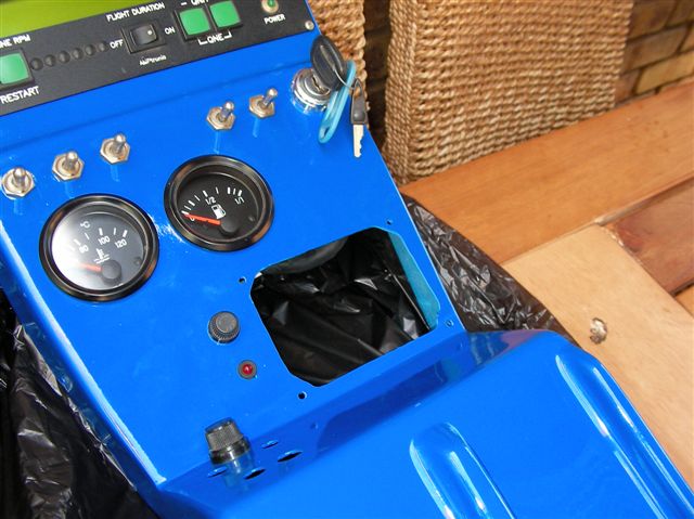

Postby Bundy » Thu Jan 17, 2013 8:31 am
Negative....we have a banana pod with toggles.
This photo was taken before the vinyl "on/off" stickers were added. I dont think there is any "legislation" dictating the switch position for NTCA WCM's?
