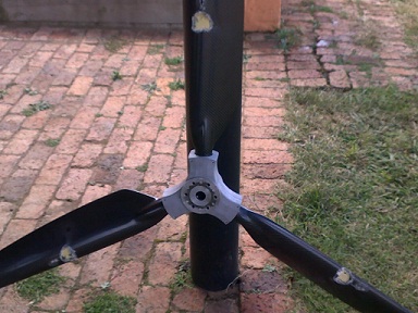

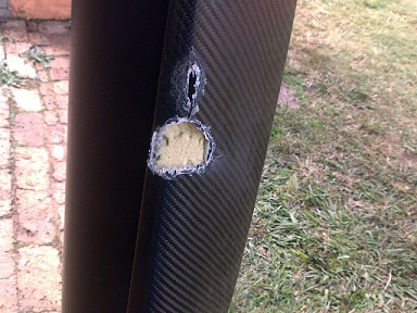

This has happened on a few occasions! Even to pilots still on the ground. Have a look at a prop when an exhaust just comes loose from one bolt!
Now the BEEEG question, how many trike pilots have their exhaust secured by a safety cable!?
my2c
my2c

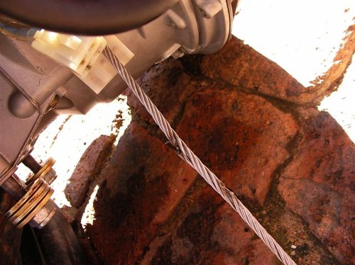

Also on the "general safety" topic....
DBP remains are now in my garage in Newlands. I started stripping her down slowly yesterday. I was quite shocked when I disconected the Earth strap from the engine frame (582 Aquilla2). I suddenly nicked my finger on something sharp... after getting a plaster, I had a closer look.
The cable loops up from the frame up to the starboard side of the motor. Its about 6mm stainless steel braided cable uninsulated (its an earth of course). The cable passes above the battery box on it way up to the motor. What cut my finger was two distinct "arc marks" on the cable. At first I was confused but then I realised how the arc had formed!
During the roll over, the battery must have slipped up out of its box... this caused the positive terminal to make contact with the earth strap/frame and what must have been a hell of a spark!
This is how a fire can start ! We all know that trikes dont catch fire very easily... but here we had at least two distinct sparks.... all that was needed was a fuel source!
Go check your batteries are secure! I am also going to look for a suitable rubber boot that I can fit over the positive battery terminal to prevent this happening again. I will take a picture of the "arc marks" and post it later.

Bundy wrote:Also on the "general safety" topic....
