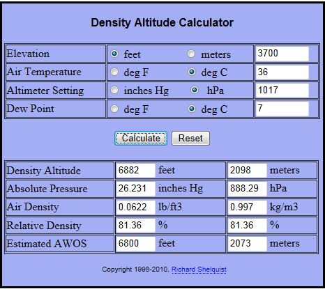

In this heat wave that we are experiencing at the moment and the accident yesterday at Aeroden, I don't think we always consider the density altitude when flying in this heat.
Maybe we can learn out of this. Here is yesterdays calculations for Aeroden. I am not 100% sure of Aeroden's altitude but:

Aeroden is 4100ft

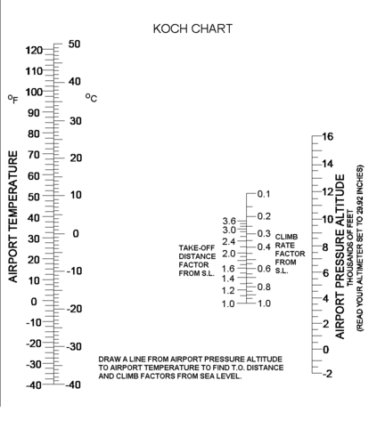

I have this with me all the time.
- koch-chart.gif (23.01 KiB) Viewed 2080 times
