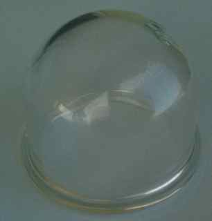

Rusty, I owe you a beer mate !! I have contacted Sarel Rautenbach and the product he has produced for us far exceeds my expectations, absolutely brilliant product. It will be a wing tip strobe with a LED position light and a Xenon element.
This forum is brilliant...
See picture
Zulu1
Wing tip strobe lens

Nicow, absolutely no reason at all for a high price, its a combo old and new tech xenon (high bright) in a small package with LED around the inside. All materials are local and the biggest cost for another manufacturer would be the heat sink. We are going to cast ours as the foundry is next door. Main issue is (was) the lens and thats sorted. Another really good company thats helped us out is Swan Metal spinning in Cape Town who are spinning the housings. So there are some really switched on chaps in the Cape..The Xenons are used in toll gate indicator lights and freely available, Mosfets are used in vehicles and millions available locally. Hopefully we will see lots of flashers in the sky. I will run a forum special, lets get them finished first...
