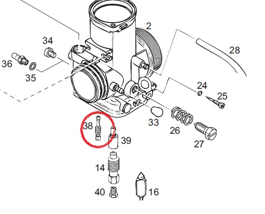

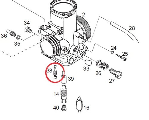

Re: carb question
Postby Morph » Sun May 16, 2010 6:48 pm
Not shown in the May 2009 version of the Illustrated Parts manual
