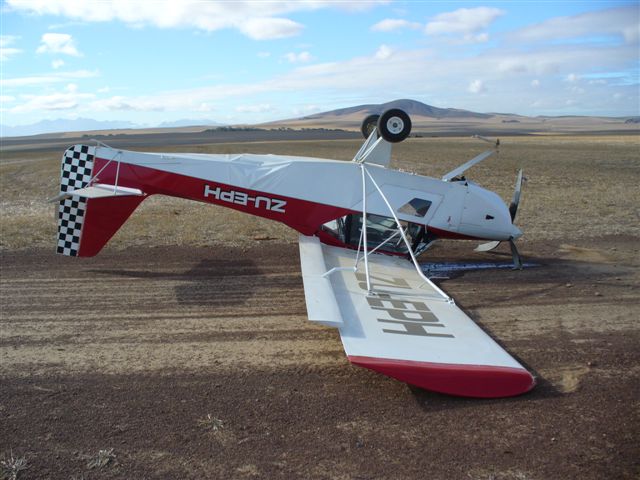

From personal experience of landing an aircraft at a remote uninhabited airfield, having a front wheel come off and ending up inverted, hanging from the seatbelt, fuel pissing out all around you, fortunately no injuries apart from bruising I discovered the following (NOTE: This happened last year January, she is repaired and flying again)
1. A fire extinguisher is an absolute must, while trying disconnect the battery cables to prevent a spark, a short occurred and set the insulation of the throttle cable alight. (my battery is now much more accessible and easier to disconnect). Fortunately once the insulation had finished burning it stopped, but this was under the dash, right next to the 5 liter header tank, full of fuel with fuel pissing out of the 100 liter wing mounted fuel tanks, that had ruptured.
2. Even though I wasn't injured, a simple head wound, cut arm or leg, could have put me in mortal danger. It took 30 minutes for the first help to arrive. Finding a remote airfield that you are used to getting to in the air, by road is quite difficult. It is highly conceivable that I could have had serious injuries, fortunately a strong airframe and 4-point harness saved my bacon
3. I didn't have any water. You have to carry water, Altona, by air is just 10 minutes away from Morning Star, but there is nothing there, no water nothing. With a broken leg, might well have been in the middle of the Karoo. This should be part of the first aid requirement, 2 liters of water.
Since then there is always water in my aircraft, plus a good multitool, for survival. Also, I always carry my phone in my pocket, when the world turns upside down, stuff flies all over the place. Aerial broken off, because it was on the roof, rendered the radio useless. (it is a handheld and I also carry the little rubber antenna with me, just in case.)
Let's stop arguing about this and find a way to comply. I hear what the trike guys say about the extinguisher, with no panniers, but end up at an airfield, blown over by a crosswind, and your beloved aircraft set's alight, or heaven forbid, your pax is trapped in her seat, inverted, fuel everywhere about to explode. There is enough mounting space anywhere on the trike to mount an extinguisher in a suitable, secure bracket. (Brackets similar to the ballistic chute for example) Also a simple first aid kit, with secure straps, secured to the kingpost, or under the trike.
Notice the fuel pouring out from the wing
