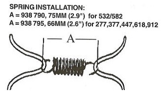

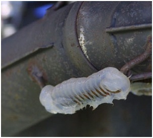

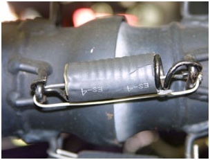

I battled with why the springs lasted 300 hrs and then once replaced one would break per flight. ##
More info in these articles.
Difference between 582 & 503
Spring liberally Silicone Rubered. Not so neat but so what.
Heat shrink installation, two globs of silicone still need to be installed on each end of the spring hook.
