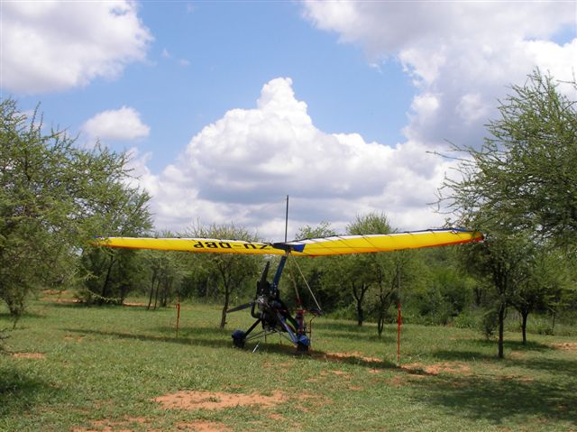

Forgot about the few pic's I took before the camera died...(again) :roll:

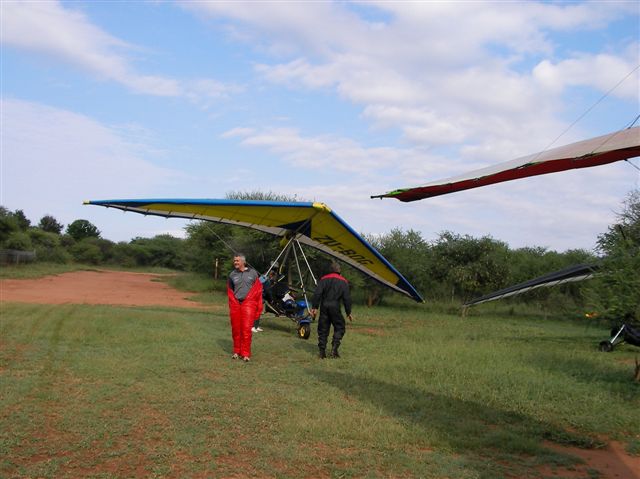

Sir Francis slowly getting out of his "Mr Incredible" suit

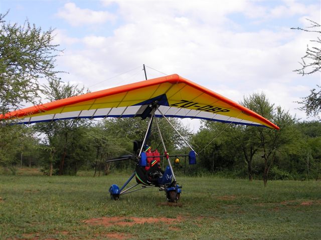

The Beautiful Dawn was really at home in the bush 8) Tie down Kit, although not really tested by the elements worked well. 8)
