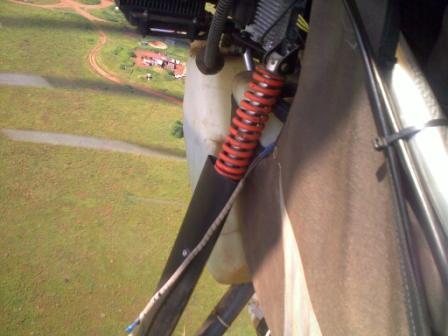

On some Sunday I set out with some of my formation flying team mates for a flight to the Vaal dam where we were to perform a formation flypast for the Round the Island race. En-route, near to Henley on Klip we flew around a model airfield that we have performed a couple of shows for in the past. After we had flown a small formation fly-past we set off for the Vaal dam again. Guy Bragge, one of my team mates, called over the radio to say that one of my wheels looked odd, somehow hanging down. Since we always rag one another en-route I thought that he was joking, but he insisted, so I looked at my left wheel, all well, looked at the right one, uh-oh…
UC Pic1.jpg (30.19 KiB) Viewed 1109 times
It was indeed hanging right down, making the aircraft look like a bird with a broken leg (in the picture you can see the leg hanging almost straight down; there are two thick black struts going to the wheel and one silver coloured one- that is the drag link and it will be utilised later in the story). We turned back to head for our home airfield, Panorama, and I started trying to figure out how I was going to land. I had a fair amount of fuel, so maybe I could just fly round and round till someone thought of something clever… or maybe until it all went away.
It was a 20 minute flight back and I sat and did some thinking about how to land the aircraft; my mates chipped in with suggestions and I could imagine them thinking, “I’m glad that’s not me…” Although we can land quite slowly in these aircraft the danger on a landing like this is that the wheel collapses and spins the aircraft around or over, which can be unpleasant, at best, for the pilot. I was also wishing it wasn’t me…

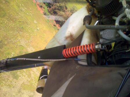

Here you can see how the one black strut, with the red spring at the top, has come loose from the airframe, the second picture makes it clearer

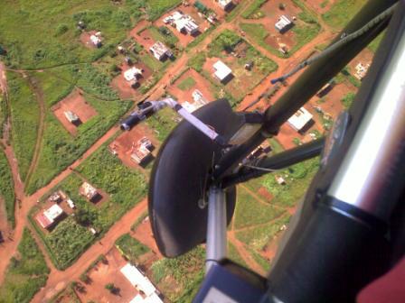

When we got back to Panorama I flew around in circles for a while as the other guys landed. During the circling I took these pictures and tried to figure out any other way to land safely. The team got hold of cars, fire extinguishers and first aid kits and drove to the runway to the point that I would try to touch down at. By now a few other pilots had heard of the dilemma and two aircraft had landed at Panorama. Two aircraft were also circling above me, waiting. Everyone likes a good crash- except the crashee! 
The guys on the ground told that they were ready and so I set up for the landing. I got onto final approach at the correct height, thanked the guys for their assistance so far and shut the engine and electrics off. This meant that I could not see my airspeed (monitored by an electrical instrument in my case) but I am luckily fairly intimate with my aircraft and can ‘feel’ the wing to tell if it is close to a stall (in training I teach my students to fly without instruments as well).
I was now in a glide attitude with 300 feet to go touchdown. I leant out and grabbed the drag link of the undercarriage and pulled the wheel and struts up into their approximate position, and started to position the bar to slow the aircraft down. Sinking slowly to the runway the aircraft wobbled a bit in the thermal turbulence but I managed to control it fairly accurately all the way to my intended touchdown point and made one of the sweetest landings I have ever made, rolling to a stop in about 20m with no further damage to the aircraft. I was pretty amazed! The top of the broken strut wedged itself in somewhere and held so it was almost like a normal landing… I sat there feeling pretty damn exhausted though- it takes fair amount out of you and you feel emotionally drained afterwards.
It was great to fly with other pilots who were calm and rational in their approach and to have had sufficient experience not to panic myself. All in all I was pleased that I had done the correct things and managed to bring the event to a safe and successful conclusion. Another wild experience to add to the list
