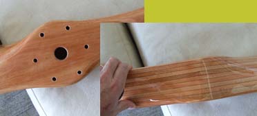

See I am confused already, the prop came like this - no bolts, no plates. Where can I buy the bolts, what diameter, length (prop 83mm wide), type? Do I need special plates?

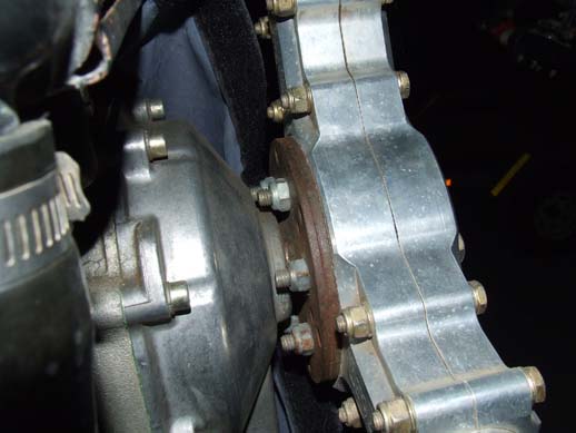

Hi Gert. 8mm x 100mm cap screws and I used the same plate that was used on my Warp prop. The nuts are M8 nylock type. Some guys have small holes drilled through the bolt head for safety wire but i haven't had a problem with them coming loose.

The two pictures - (1) the plates on the warp - will they be OK for the deNecker and (2) a new family member. The bigger dog, Coffee had his second laparotomy for obstructed bowel three weeks ago, and has had seperation anxiety ever since he returned from the vet (8K later). So I got him a friend yesterday. The new one is called Ginja, and has blue eyes and is almost completely white. Not a good start in the new SA.
